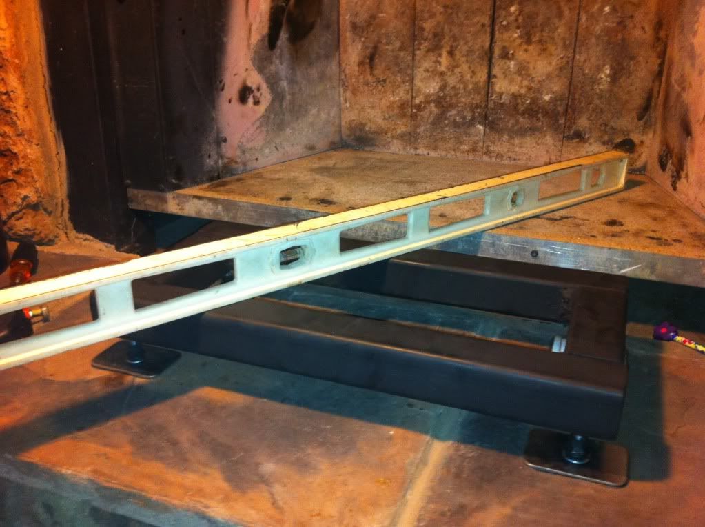

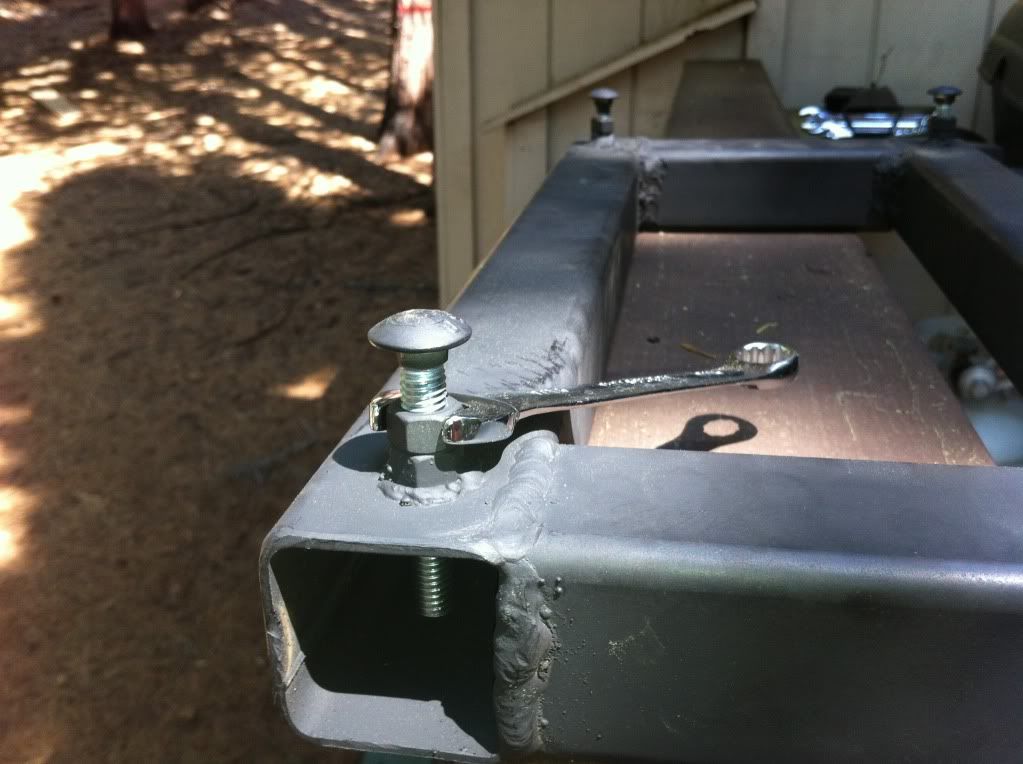

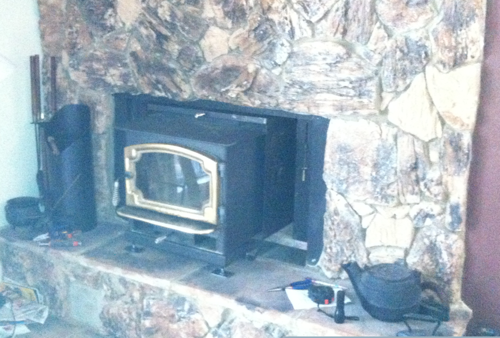

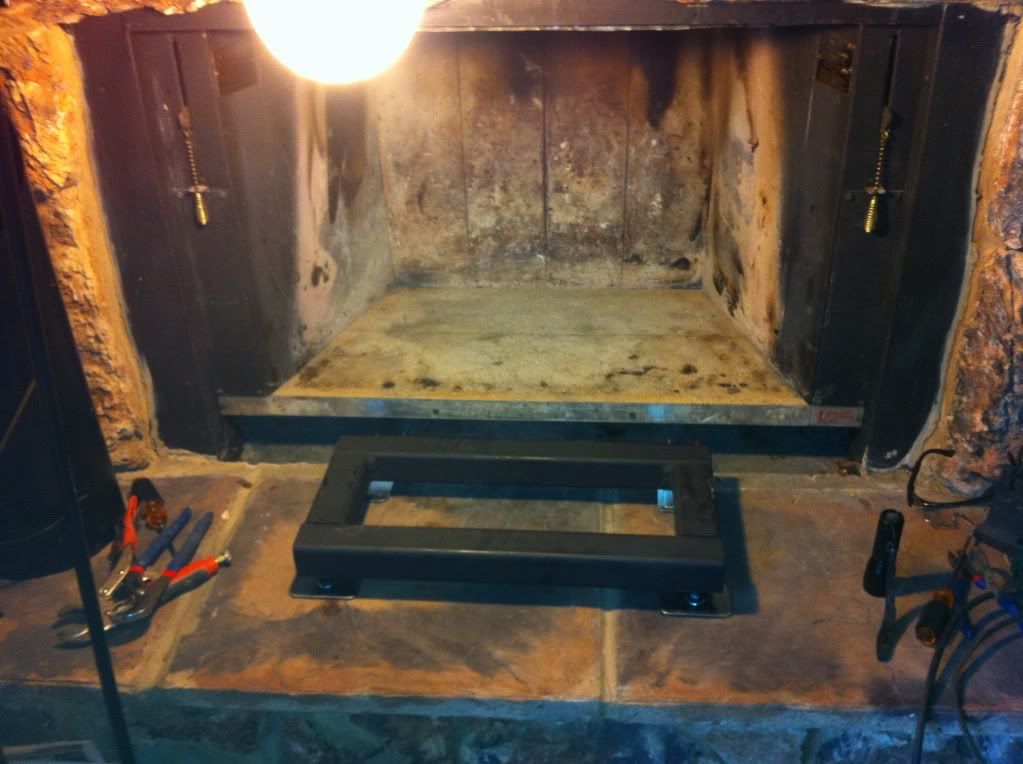

I just wanted to post some update pictures of the spacer I made to take up the 3 or so inches from my hearth to the fireplace. I finally got time to do the install, and it looks pretty good. Now I just need to run the insulated SS liner and connect to the top of the stove and run to the top plate of the chimney. I also will be customizing the flashing around the insert and hope fully will post the final set of pics when I get that done as well.
