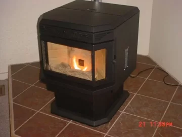

Well I have burned up 1 ton of pellets so far and everything seems to be good. 19 days averaging 2.6 bags a day. (we like it warm in our house, lol) I have taken the fake logs out, seems I can make it 3 days before I have to clean the stove out that way. The stove is nice and quiet in my opinion. No creaks or groans, blowers are quiet even on high. Ocassionally you hear a pellet get crunched by the auger, but not that often. When the outside temp is above 35 degrees we run the stove on setting #3. Outside temp below 30 degrees we run it on high #5 setting. This keeps the living room just under 80 and the rest of the house between 65 and 70. Not to impressed by the door latch at first, before we started it for the first time I had to file a little rounded groove in the hook to get it to latch on the pin but it works fine now. The glass has some spots that when cleaned still show a slight bit of fog on it, not really a big deal doesn't affect the operation of the stove just the looks. Other than that I can't really complain at all. I am planning to buy another ton of pellets this weekend. I was told to try the Dry Creek brand, alot of people tell me they have good luck with them(less ash). Cleaning the stove only takes about 15 to 20 minutes and is pretty easy. One thing I wish was different is the handle for cleaning the heat exchanger is inside the fire box. Have to open the front door to clean the heat exchanger. I noticed other stoves have that feature out on the front of the stove so the door can stay closed to clean the exchanger (preventing the ash from coming out into the room or on the floor infront of the stove). Oh well, can't have everything for $2200.00. lol Nice stove in my opinion though. So far it was well worth the money. I'll keep you all posted after the next ton is burned up. Probably a little after Christmas. Happy Holidays and Merry Christmas to all of you.

Nice looking stove! Glad you're keeping warm.
80 certainly is warm. One little tip that most
stove owners use that seems to work well is to run a
humidifier. It helps to make it feel warmer
so low to mid 70's will feel much warmer
without having to burn up as many pellets.
Ya might want to give it a shot.
Happy Holidays back at ya!

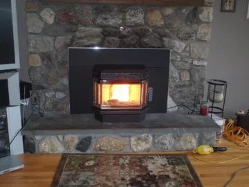

HI, New to this forum. I just purchase and installed a Hudson River insert today, 07/11/2008. Getting ready for winter. We use oil heat and at over $5 a gallon in NH I figured why not. I fired up the stove and it seems to work great. Very quiet and HOT. I purchased thru a local distributor who sells and sevices his products. Picked up 5 tons of pellets for 249 ton and free delivery, not bad I suppose. He said his price just went up $20 a ton. I hope that will not be a trend. Any how so far it looks great and even thought its still summer, I cant wait to fully put it thru its paces this winter. The flame looks awesome.

Congrats on the new stove. It looks great and you are headed for a warm house this winter.
