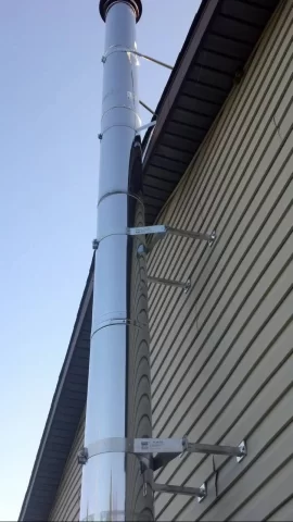

@DexterDay may I ask where you sourced the stand offs on the house ? The pieces that allow the class A to go straight up and make its way past the eaves ?Looks like a neat install.

Custom made by a Millright/Maintenance Man at work. I gave him measurements and hole placement. He gave me the pieces that look made to fit.
Its just 1" square stock and a 3" x 3" flat plate welded to both ends. Then several coats of Shiny Silver and a couple with clear.
I didnt want to cut my eave... That was the easist way to go around. It took an extra 12" Class A section added onto the T going to the Thimble. But works well. Its 18' of Beautiful Class A reaching to the sky.
