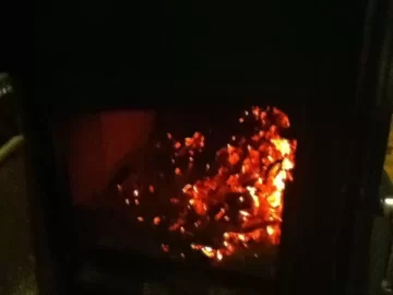

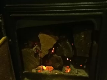

OK, here goes a try to up load a sequence of pics with a sequence of replies:
1. Move coals to the front:
  • [Hearth.com] Use extra coals - top down reload

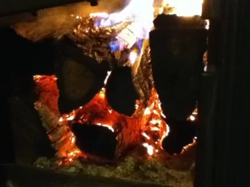

2. Place large split in the back bottom tier, second split next to it on bottom, fit a split on top of the back bottom split (Back second tier spilt):
Getting my numbers mixed up from the original post -

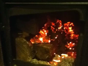

Fit splits in the rest of the stove and a piece of soft wood on top of and in front of the coals on the "shelf" (on top of the second bottom split)

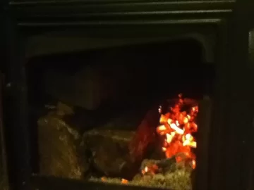

Five minutes after packing stove - (I had to leave the side door open because my soft wood split was not as seasoned as I though, I think I grabbed it from the wrong pile)

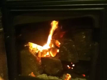

About 20 minutes after packing stove, with coals shoveled up on "shelve", stove top was about 500 degrees, secondaries real strong, bottom tier of wood doesn't look like it's burning, while top is going to town. (Pic of the inside is immediately after opening side door)

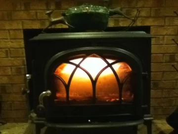

At about 35-45 minutes after reload, my stove top temp (back, left hand corner) hit 700 F. Scary. I think it may have been due to leave the side door open too long right after reload, and then when secondaries got strong at 20 minutes, I opened the door to take the pic at 20 minutes. So I put a stove glove over the air intake. I have a 3" piece of flex duct connected to my OAK air intake, but it does not connect to the outside). So at 1 hour, the stove has settled down to 600 F. Going to bed, I will see what I have after 8 hours or so.

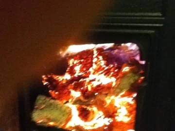

Photo after 60 minutes, stove top 600 F, after 15 min of blocking the OAK with a stove glove
Healthy coals bed this morning, 8 hrs later. More than enough to do another top down reload by shoveling the coals up on the "shelve" created by a couple of splits placed in the back. An hour later, stove is cruising at 650 F.
