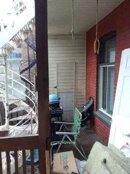

If the vent goes out the side of the building, there's a balcony with another balcony above so it's kind of covered. Attached picture.
What's the code on where the vent can terminate in this case?
Again, you will have to look at the unit's install manual for acceptable venting clearance specifications.
Nope. All units are different. The install manual is the "Bible," unless local codes say otherwise.
