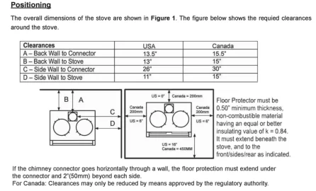

Greetings everyone.
First post on the forum. Been hunting the interweb for all necessary info and specs for installing an ESSE Ironheart into my new home.
Here's a bit of the run down... Cathedral style ceiling, planning on offsetting 6" stove pipe 9-12" from roof peak, (going 12" will make my 6" stove pipe die right on 18", or where my first interior truss sits....) maintaining 2" clearance from combustable's around trusses for "attic" support box, using double wall pipe for interior and fabricated heat shield that attaches directly to stove from supplier called Obidiahs. Looking at 9" clearance from combustable dry wall to back edge of wood stove with heat shield between. Supplier says 9" is adequate with heat shield, so everything from floor up seems good to go.
My question of biggest concern right now is the idea of using hot rolled steel as a hearth pad. Has anyone used it before and if so, did you use durarock between steel and subfloor? or any sort of airspace between steel and other materials? and what was your fastening process for steel to underlaying material? screws for subfloor and thinset to durarock?
Thanks for any info...
