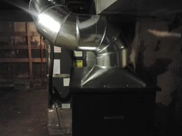

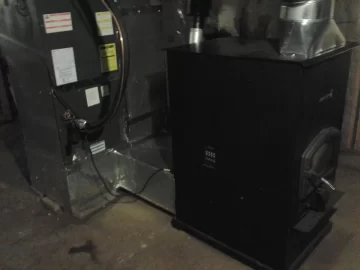

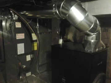

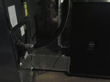

i only have one backdraft damper and its on the distribution side, nothing on the return side. i dont know all of the settings and actual firing rates. i dont think the 6220 is as adjustable as its brother the 6100. i just ordered a stove thermometer so i will be able to measure the temps by next weekend. the unit is not being controlled by a thermostat. you are correct about the second blower. thats why i removed the rear cover to verify that they were both running and they were. now i will try to upload some pics.
[Hearth.com] usstove 6220 pellet furnace installed but got a problem
Can you get access to a CFM meter so you can measure the actual airflow coming out of each register.
I also can't really see a lot in the way of sealing on each of those joints.
You should also get a hold of USSC and ask them about what the firing rate constants should be and how to access them on that controller. It is possible that they are incorrect and if you don't burn enough pellets you don't get enough heat out. Also if the unit can be operated in manual or automatic mode will make a huge difference in how the draft gets handled. In manual mode you have to vary a damper to match up with each firing rate. In automatic mode the damper is left open and the combustion fan varies with the firing rate. USSC uses several controller and controller setups. As far as heat itself is concerned you have a rather large metal radiator in that venting so you are going to send a fair amount of heat into the basement.
I'm a little concerned that the return air isn't going into the USSC and being block from entering the furnace.
Also have you verified that the auto damper in the distribution system closes and closes fully when the USSC is running? You don't need any of the airflow from the USSC going backwards through the furnace.
no access to a cfm meter, if they are not that much i can buy one.
i dont feel any air leaking around the dist joints, i plan on sealing them up though after i make sure everything is ok and i dont have to take them apart
i have done some research on the old i burn corn forum and found that USSC will not give or tell any info to change the 6220. they did for the 6100 but i guess they claimed that they got the 6220 right and it should be run on auto.
i think the return air is ok. when i removed the rear panel from the 6220 that pretty much eliminated the return air and it could just draw air in from the basement and it didnt change the airflow at the registers.
the damper does completely close to where no air is entering the electric furnace.
