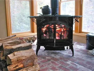

We had a Defiant Encore that was 14 years old but got rid of it last year. Loved the look and it gave us great service over the years but needed some repairs and a new catalytic converter so we gave it up. We hated to do it but bought an Isle Royale and really like that stove as well. Starts easy, heats great, easy to operate, looks great...my basic requirements! Can't wait for the temperature to go down here so we can have our second fire of the season.
+1 We're also former Defiant-Encore users who (eventually) switched to an Isle Royale. We had a gorgeous Midnight Blue enamel D/E with the warming shelves--truly a gorgeous stove and a good heater, but maintenance costs were just too high...
We had an Oslo that we used for two years, but it just didn't work out for us, so we switched again to the IR which so far we really, really like a lot!
