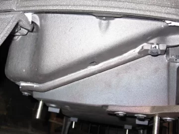

This pic is of the left side of my encore2550. Can anyone tell me what the hole directly in the middle of the screen is for. It is on the molded cast iron part that runs at a 45 degree angle from the back to the front. The hole is threaded, empty, and points directly upward. The stove is not running so I can't wave the incense stick to leak test it yet.
Thanks for your help in advance.

Combustion air if I remember from the old Encores. Lets the stove breath when the primary and bypass are shut down all the way. Thats my guess based on 20 year old memories.
These are not the "epa" holes commonly asked about closer to the ash pan. These holes are threaded and on both sides. I'm hoping they should have screws or bolts in them to close them and they are the source of my leak.
+1 to Frank.
I just checked my old 2550 that is in pieces. It has the same holes. On my 0028 I plugged them due to some air leaks....that will be addressed come summer.
thanks... when I plug the holes my glass gets very dirty. I'm having trouble finding the happy medium concerning my draft.
I bought it off of e-bay 3 years ago. Discontinued color, country cookware gray.
Paul,
I sent you a PM, but I figure it's worth mentioning in the thread.
MHSC tech has confirmed those are the "EPA" holes. They connect directly to the air manifold.
I've stressed the fact to them that you've done several smoke tests on this stove with no leak findings. They are convinced it's a draft issue at this point.
