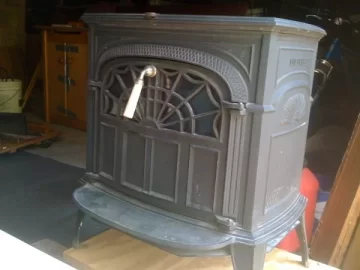

I'm interested in buying a new wood burner for our home. It would be heating a space approximately 1200 sq ft. (Our second floor is radiant baseboard, the first floor was heated with a pellet stove, but the stove was removed prior to selling to us). We were going to buy new, however I found this Vermont Castings Intrepid ($350 asking price) [Hearth.com] VC Intrepid on Craigs list and was wondering about the model. All my research says it could be the ticket, but I thought it prudent to ask here on this forum. Is this a good quality stove, and what should I keep my eye out for when buying used?
The Intrepid is too small for your needs.
Yes too small it's half the stove you need.
Too small, hugh? Everything I read said this was the right square footage. Are they not as efficient as they claim? Should I be looking at models that claim 1600 sqft or better?
An intrepid will not heat 1200 sq ft.
It has nothing to do with efficiency. It is a 1.3 cu ft stove, with little size or mass to throw heat. Ignore heating square footage claims. They are just as bad as BTU claims. For 1200 sq ft Look at something closer to a 2 cu ft firebox stove.
Okay, thanks for the info. I do like the style of the Veront Castings stoves though. There also happens to be a Vigilant for $200. It's 25 years old and I probably wouldn't consider getting such an older stove for my first one, but as long as I'm asking questions... could this be a good buy assuming it's in fair condition?
If it is in good condition (no leaks, cracks, or warped parts, and not rusted to hell) the Vigilant is a very capable heater.
But, it might blast you out of the room. It is the equidistant of a modern 3 cu ft stove in terms of how the heat comes off the stove.

Hello there, a good buddy of mine has the Intrepid and his place is about the size of yours. He doesn't burn 24/7 but when it is going it really heats up the nearby rooms and he uses mini fans and venting to get the warm air to the second floor. His one complaint is burn time, says he can load it up around 10 pm and it is hungry for more wood by around 2-3ish. He says by 6 or 7 am there are no hot coals left, so it will provide some heat but will require you to keep her fed perhaps more than others. We have a VC Encore 2 in 1 newer style and so far we haven't turned our heat on, she keeps our 2,400 colonal home warm (68+ degrees) without pushing it too hard this year but it has been a little mild. Some nights as you know have been cold, others not bad. Good luck on your search!
