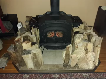

We love our 1985 Vermont Castings Resolute III. It burns so well that we have NEVER had to clean our straight stainless ~8ft. chimney. It comfortably heats our 1800 sq. ft. ranch house and leaves the bedrooms cooler for sleeping. I have kept it serviced with new gaskets and inner castings (which are still all available from Woodsman Parts Plus). If you put that stove on eBay or craigslist, people will fight over it. I paid $199 for the warming shelves (PN 0001560) in 2022. (I made them work with 1/4" - 20 metal clip nuts and longer set screws.)

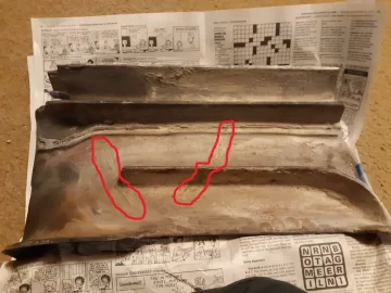

I just replaced the cracked lower inner casting (See the picture). The lower section is part of the "damper down/extended burn" smoke path. It was 70% blocked with ash. I have to believe that this led to uneven heating and caused the casting to crack. I will add cleaning ash out of this casting to my maintenance. Our stove works like new again. It too a long day to replace the lower inner casting. Two screws broke and I had to bring my MIG welder into the house to facilitate removal of the broken bolts. My hands and arms were covered with soot.
