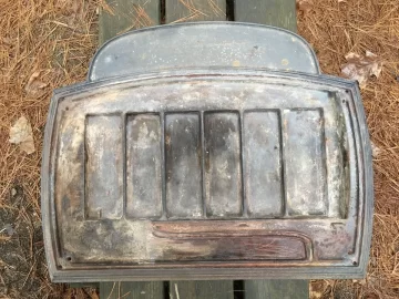

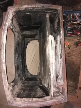

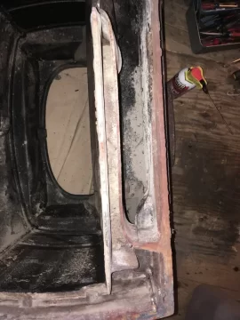

rwh63
Feeling the Heat
Nov 12, 2019
435
MA
A little extreme, but you could roll the stove into its top, ratchet strap the body, and detach the bottom. Complete access, prep the sides and bottom for recementing, and put back together. Here a vigilant with its bottom off.
F0ED18F3-8A7E-4F80-81BC-EDAC410216A7.jpeg 8B358702-E551-4FDF-9FE7-D9C27138EC82.jpeg 794A0B3A-A69B-451D-8110-94EA8ADC7EC7.jpeg
