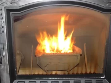

I just took a picture today!!! This is after less than a day burning and a good cleaning with a proper glass cleaner made for wood/pellet glass.
Interesting, very similar to my glass except the air marks on the bottom only go half way, right to left. The other difference is they only go up about 1/2" from bottom. The dealer suggested lowering the air intake, which I tried, but the stove did not burn as well.

We've had issues with our insert smoking, but am happy to report it's all been taken care of now. Just wanted to post a pict of the glass for comparison after a day and half (36hrs give or take) of continuous burning. Both on room temp and stove temp. Low and high fires. We have the log set, which isn't in this pict, as I forgot to put it back in. Corny, but the 'log' makes my spouse feels more like a real fire and less like a stove.
Aries
You're glass is much cleaner than mine after a day, what are you burning for pellets? Room or stove temp? Settings? Was this with the log set in?
