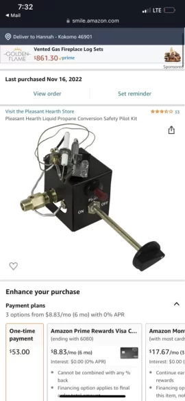

Thanks for your reply. Here is the picture of the pilot assembly which was part of the conversion kit. I am sure it is vented.

Thanks for the pix, but I'd rather see what you HAVE not what you BOUGHT.
Are you sure everything is tight? Sounds like the gas is not getting to the pilot
for ignition. It's going somewhere else. Word of warning: LP is heavier than air.
It will "puddle" in the bottom of your firebox until it gets deep enough to reach
the pilot flame. When it does... "PHOOM!"
