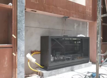

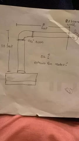

I am new to the forum. We are building a home in GA. I bought a gas fireplace which will be installed in the middle wall on the first floor of the house. We did construct a chimney but our architect never considered building a frame on the second floor for chimney flue to pass. Now making one will ruin the design of the second floor. I am thinking of running the chimney flue vent pipe instead from the floor joist to the outside of the house ( see the attached diagram I hand-sketched). There will be 90 degrees turn in this proposed plan.
Is that possible or will that be a code violation or can I use a double-wall pipe? See attached picture of fireplace and vent I got from fireplace manufacturer. Not the vent on this fireplace only has a single hole, unlike some fireplaces that have 2 holes.

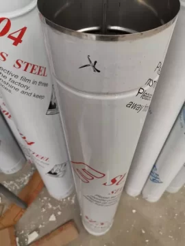

Hello - this is not from a US based manufacturer. I can tell you this is a direct vent gas fireplace controlled by remote. Their manual says single wall steel vent is good enough which is in the picture I attached. Trying to be double sure before we install so we don’t take any risks.

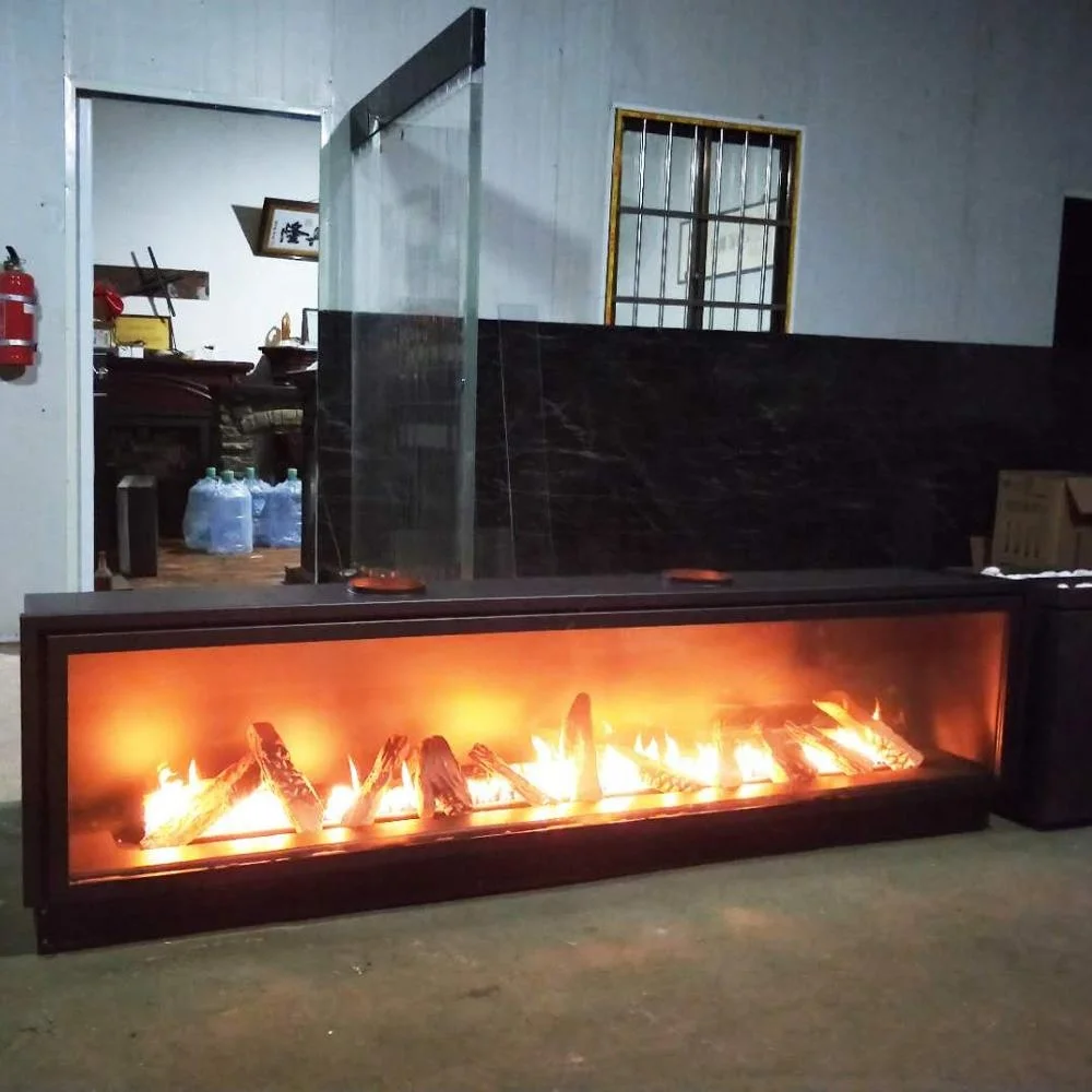

Company name is Jinan Lodor . Below is the video is working fireplace. Our fireplace is exactly same but smaller so it only has 1 vent.

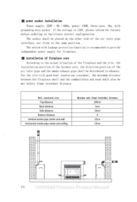

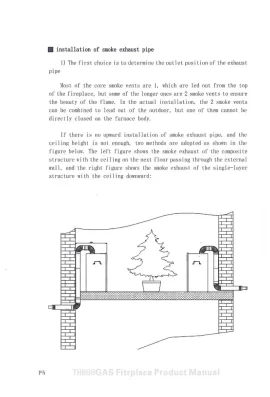

Manual attached for the fireplace. Apologies as it is page by page but all pages are scanned.

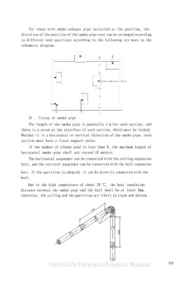

Looks like you may be able to do what you want, based on the documentation you supplied,
as long as you can meet the Clearance to Combustibles requirements cited. You will probably
need to install a power venter as you are just about at the max horizontal limit for natural draft.

Quick question on what kind of chimney flue to use. I see many options....
Can I use something like this:
Amazon product ASIN B0085VO8CC
Or do I need to use
Amazon product ASIN B00FZ9TN2C
Or would there be a separate recommendation given this is going via floor joist ?
