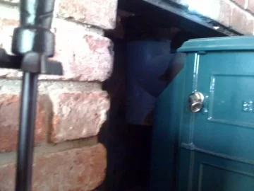

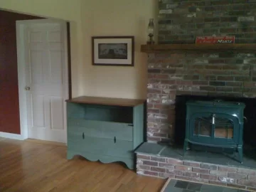

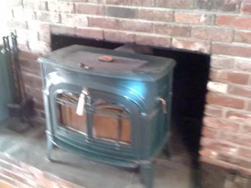

My chimney has 6 inch liner.
instal paper work states PIP SS Flex Kit 6 x 35 w TEE, Encore 6" flue collr, So it is 6 inch installed into fireplace opening

Explain what type of fire you had in the stove and how you adjusted the air controls.
Fire Box was 1/2 way full had been burning 5 hrs nice bed of coals surface thermometer around 475-500 Damper closed CAT engaged air intake 3/4 open. I was just shutting down Air intake to get longer burn for night backed it of to around 1/4 turn from closed did this over about half hour. Flames began to die out a little mostly Glowing embers a few flames but not roaring. then all of a sudden it went dark no flames and whoosh it flared up 5 or 6 times 30 to 60 seconds apart each time releasing smoke from under griddle.
I then opened CAT and gave it a little more air and it seemed to stop. It was about 25 degrees last night no wind and crystal clear outside.
