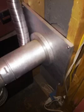

I cut a round hole and it was not to hard even though it was cement board! Just trace the pipe on the wall and start cutting!
See pic
  • [Hearth.com] video that shows install of vent
