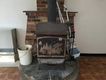

Can someone please help me determine a fair price on this Fisher teddy bear model? Really can't find much on this.

There is no "book value" for stoves until they become an antique at 100 years. You'll find stoves vary by location and season. Now being about the lowest and Fall being the highest. So whatever buyer and seller agree upon.
Any stove with a UL Tag is worth much more since it can be used legally in states other than CA, OR and WA. This should have one on the back since it was a tested model. It should be on the rear shield.
This one having brass plated doors makes it more desirable than a black door, but look closely at the plating to make sure it was never cleaned or polished with something abrasive. For me that would lower the price considerably. Others may just need it for heat in an area where they aren't concerned about looks. Is the Fire Screen in good condition that should come with it? They can cost around $100. Firebrick condition can lower the price if you can't replace it yourself. Those are the factors to consider when pricing. Not much wears or goes wrong with that model.
From a collectors standpoint, new in box and never fired I would pay up to $800 and travel the entire East Coast. That used stove needing reconditioning for my collection, $200 within a couple hours. That's my personal price range and I have most all models using those guidelines. Some were acquired cheaper (one free) the cheapest being $80 and the most over $1000.
