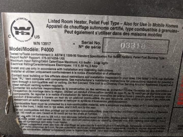

Heres a pic of the plate The stove would be the same as Breckwell classic cast 4000. The stove will continually shut down and then after about 30 minutes of reactivating it once it gets going it will stay on. TOI me it seems like the low limit switch but I replace that . I guess I could hot wire it and see what happens the #2 light is flashes on error code
