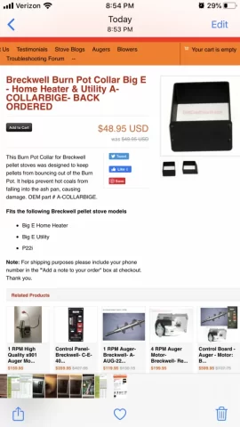

The pellets are bouncing out of the burn pot before they burn completely. Breckwell sells a collar. See pic below. The burning pellets in the ash pan could have contributed to the warpage. What I do is drill a couple holes and use nuts and bolts to help bend it straight and add high temp silicone to seal the front part of the ash pan and put silicone in the corners to completely seal the ash pan.
That will make it run effectively like it should.
