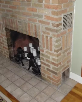

Any suggestions would be greatly appreciated, below are two photos of our (less than ideal) fireplace.

Welcome, there is a ton of knowledge here. What kind of fireplace do you have there? It looks to be a heatilator-type. The firebox also looks to be metal on the inside. Have you opened up the damper and looked up to see if you have a clear shot up the chimney?

Add some measurements of the firebox (h" x w" x d") and hearth area in front of the fireplace opening to get some better advice.
From the pictures, it appears that you will have to add some hearth protection extension out onto/into the wood floors, and to my eyes, the firebox looks quite small and prefabbed.

Thank you for all of the replies! Yes, it is a heatilator type fireplace with a metal box that angles up to the front, creating a narrow damper (19 inches wide but only about 5 1/2 inches deep). My hesitation about a cat stove is that I have heard the cats only last a couple of years, and I want to be able to burn just about anything (unseasoned softwoods in a pinch if it comes to pass) which, as I understand, would kill the cat. I also think the oval opening that VC just discontinued in the Encore would work better for us with the narrow damper (thereby avoiding a bunch of connectors which would increase how far the stove came into the room, or cause us to have to machine out the metal liner of the fireplace). The Resolute is another choice for us, but sticks out farther than the Encore.

What you actually have is a Heatform, have one here. Don't let the narrow damper limit you. You can cut out the damper to accommodate a regular 6" round liner. I did here myself.

You will prolly need a rear exit stove if you plan on it being out of the old firebox, and that is the only way you will fit anything like a dutch oven on top.
Or you could got up and into the chimney further above the fireplace and through the wall. Much more prep/finish work there and might not be as pleasing to look at.
