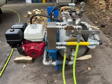

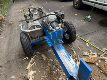

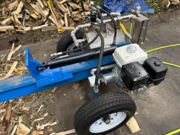

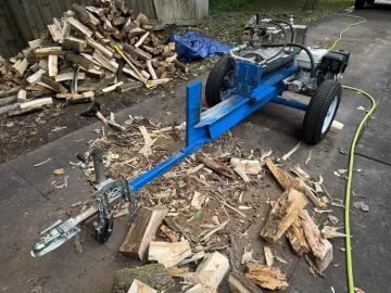

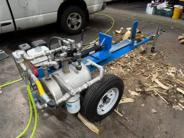

Finally got around to taking some photos to post on here of my homemade logsplitter I built last year. Searched around the internet for any logsplitters with water-cooled hyrdaulics and couldn't find any. So here is the (known) first. Professionally, I am a Pipefitter/Welder.
-Approx. 19 ton capacity
-6.5 second cycle time @ full throttle
-Water-cooled hydraulics via plate heat exchanger
-Stationary single razor wedge design. 12" tall
-Honda GX390 engine
-28gpm 2-stage hydraulic pump (Northern Tool)
-4"x24" hydraulic cylinder
-Frame, reservoir, structural, axle, piping, fittings, hoses free from workplace surplus
-Total cost approx. $1300
Open to questions, comments, etc.
Can take measurements and close up photos for those wanting to build their own.

It looks nicely done. I can't recall our splitter ever overheating, even when splitting for about 6 hrs. Is this a common issue?
Thank you. I added the water-cooling side of it after running it without for a little while. Hydraulic fluid crosses into overheating territory after 140F. Without the water-cooling I was spiking the reservoir temperature well above into the 160Fs+. Ideal hydraulic fluid temperatures are between 110F and 140F for maximum component life. Construction equipment and air-cooled logsplitters solve the problem with active cooling.
I can't speak to how your machine does heat-wise. A lot of factors at play. Ambient temperature, throttle speed, work speed, cylinder port and hose sizes (smaller adds friction), etc.
Without the water-cooling, I could throttle down and keep the temperatures within range, but who has time for that?

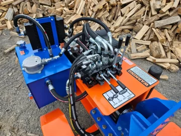

Here is the oil cooler mounted on top of the reservoir of an Eastonmade 12-22 logsplitter. This was the splitter that I based much of my design and material sizing off of.

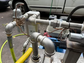

My first working version of my logsplitter did not have any active cooling, and I observed some hydraulic temperatures as high as 160F+ indicated by my reservoir temperature gauge. It was at that point, I found a cost effective plate heat exchanger which would handle the heat with no problem. The valve on the cooling water outlet of the plate heat exchanger modulates the water flow through the heat exchanger and keeps the temperatures stable at the setpoint. In my case 110F. The excess heat is expressed as a little water trickle.
