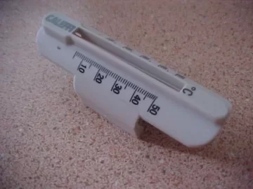

these snap on thermometers were built for balancing radiant loops. They fit 1/2" pex but they do "stretch" enough to fit 3/4' copper tube. Smear a bit of heat transfer paste and snap them on. This one happens to read in C. I have some that read in F also if you want to try some let me know.
hr

Those look like they should work. Not exactly what I was looking for, but workable. How much are they? I would want a half dozen or so. PM me with your contact info.
JB

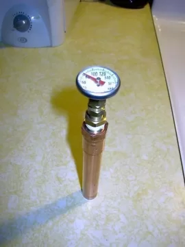

Here is a thermometer setup I am working on, it is a food thermometer that is mounted in a compression fitting in a piece of copper pipe. I will probably mount it in a sharkbite tee when it is all finished. The food thermometers are relatively inexpensive and fairly accurate.
  • [Hearth.com] Water line thermometer
