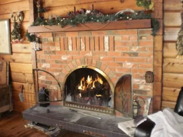

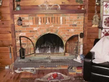

The opening, at the base is 31 inches. The height, at the center of the arch, is 28 inches. The depth of the firebox, with the existing fireplace metal in place, is 22 inches.
Here are some of our non-negotiables..... It has to heat a minimum 1500 square feet. We want as much glass as possible. The blower should be relatively easy to access for repair or replacement. We want to stick with EPA but non catalytic for simplicity's sake as we will have multiple operators taking care of the insert firing.
Ideally we would like to avoid cutting away any of the arched brickwork. We would also like to retain some element, if not all, of the arched look.
We know we will need to extend the floor clearance with tile or a fireproof surface. We also plan on installing a stainless steel insulated liner
Advise away fellow Hearth.com forum members.

Wow, that's really pretty. Is that a true masonry fireplace or is there some kind of prefab one in there?
If you could find something like "fireplace xtraordinaire" that would fit in there it would look almost the same as it does right now!
(broken link removed to http://www.fireplacex.com/product_guide/wood_fireplaces.aspx)
Or, the Regency Warm hearth stoves, etc. I don't think any of those have a complete arch like yours though.
If you can't do one of those, I would do one that does not have a surround, so that your pretty arch would still show. Like Dr.Doct's avatar on here. That wouldn't be as much glass though.
If you could fit a pretty Jotul up there, that would look nice.
I should have stated that yes, their is some form of metal fireplace built in to the masonry. Cutting it out will be an adventure.
A hearth stove like a Jotul would look great there.
I agree, a hearth stove would be nice. That's a great fireplace, but I can't picture an insert doing it justice - if you were going to keep the arch, it would have to be a custom surround, and the insert would have to be pretty small, no?

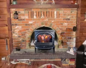

Here is a little teaser eye candy for your window shopping dreams.
  • [Hearth.com] We are now window shopping and looking for advice
BeGreen said:
When I saw that beautiful fireplace, my first thought was, so now I understand why you are heating with the Drolet. That is a really nice fireplace. It deserves special care to not mess with the look. But the problem is the height. Most stoves are not going to clear unless the legs are shortened. And they are not going to heat as well when in that deep cavity without a blower. It will take some critical measuring, but the F400 with legs shortened might work.
NICE!!
That looks awesome but... BG, I think you shrunk the Jotul.
It's shrunk, but it would probably fit. With the regular legs it's 29" tall so I assume it would be a couple inches shorter with the short leg kit, and that would put it just under the 28" height of the arch?

That's why I showed the stove partially out on the hearth. I don't think it will clear the arch at the corners, but the stove slopes down in back, so part of the back could fit under the arch. It will take some close measuring to determine this. I do like the way the Castine's door curve echoes the curve of the arched fireplace though.

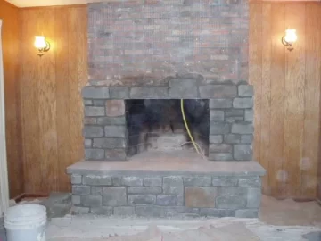

Agree with the hearth stove, but you may find that removing the prefab may not be that big of a job for a pro, especially if that is an outside wall. Nonetheless you will need to extend the front protection (onto the cool looking wood floors) for a hearth stove.

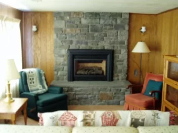

We had a similar arched brick fireplace, though masonry, in our old house, and ended up covering it with stone and using an insert (gas). It at one time had a VC Winterwarm wood insert, (the surround covered the arch), wife wanted stone and the convenience of gas, so that is what she got.

You are right, a custom surround would look nice fitted in there. Here's some hearth-installed inserts here, many of them would look great in your setup, though obviously won't have as much flame view as your current scene.
https://www.hearth.com/talk/threads/50201/
