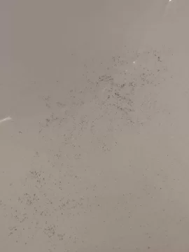

I built a house where my mobile home was and my well sat unused for 2 years. Now that we are moved in I am having sediment trouble clogging all my fixtures including toilet valve. The toilet float valve looked as though it had something that looked like algae or crumbled leaves which is not possible (just describing). Most of the trouble is fine black sand. My Rinnai 94 water heater screen has to be cleaned daily or more. I had a 5micron charcoal filter cartridge which did not stop this stuff. I have a yarn wrapped style cartridge in fliter housing now and it is black after a day. Should I do a spindown filter of some sort. This is a pic in the bath tub after use. Thanks all.

Possibly the well has silted in
can you rase the pick up (foot valve, or pump )
4 to 5 ft? If you can you may get out of the silt

You might want to get a driller out there and clean out the well bore, sounds to me like it's silted itself from sitting.

The well IS silted and needs to be flushed and not by recycling the water in the bore but by an external source. Recycling the water in the bore won't do squat except stir up the sediment in the bottom.
As an alternative, I'd pull the pump and measure how much water is in the bore versus the bottom of the hole and set the pump higher if possible. I haven't a clue what your drawdown is, but a competent driller can do all that.

If it sat for a while, it may just need to be run for a while. Hook up a hose and let it run wide open for a few hours and see if it gets better.
Reactions: oilstinks
That grit, easy to filter out. Don’t despair, you have lots of options.
Standard procedure is to let a well that has sat unused run just less than wide open until it clears. This would be be a hose bib running half to three quarters open and draining into the yard. We recently put a pump into a well drilled three years ago. The well man told me the above, and when I read the manual that came with the new pump it stated the same advice.
The couple of times I have have had a new well drilled, I have had to let it run until it cleared. Other than that, I do not know what to tell you.

Just thought I'd post its getting much better. I may end up pulling the pump up a few feet, but I can go over a week before cleaning my on demand water heater screen.

Just thought I would update on this. I can go a month now without changing the filter and almost zero sediment in bath tub and shower pan now. Thanks.
