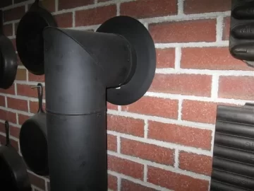

You can get an Englander at HD, Lowes or TSC in your price range. Go to a stove shop to get the 6"to 3" pipe adapter and hook her up where the wood stove sat. The only thing with using the 6" single wall is you really have to seal all the connections good when using a pellet stove or you'll get some smoke in the room. The biggest culprit will be one of those adjustable elbows, I used a welded seam one(pic attached) for a good seal, and it lets the stove sit closer to the wall.
