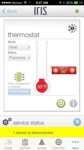

I like turning the workshop stove on with my iPhone on the way home.
  • [Hearth.com] What do you like? Dislike?
