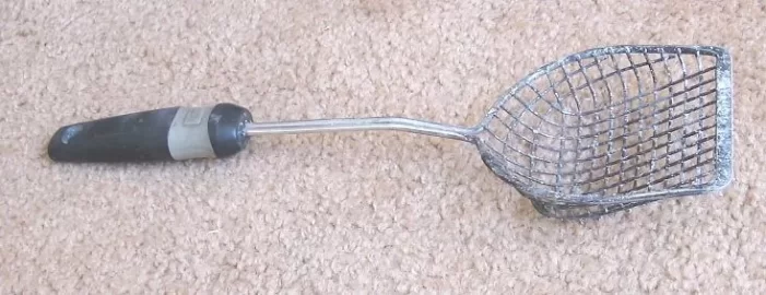

I use a metal strainer, 4" wide with 1/4" grid, found in the kitchen utensils at walmart. It works great but a 6" one with a larger grid, maybe 1/2", would be ideal. Haven't seen one of those anywhere...

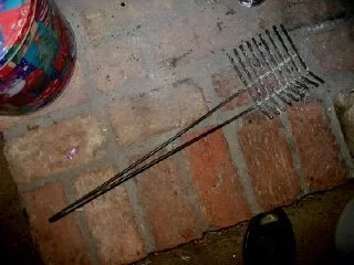

I made one from 1/4 inch stainelss rod. loop handle. a scooper part with rods about 1/2 gap spaced apart I will try and post a pic next week.
shakes and raises the coals to the top. works great.

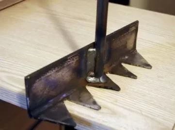

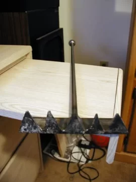

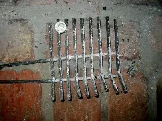

I fab'd this up, works ok to move the coals around
Looks like you got something there!

Here is a picture of the scooper/strainer I mentioned above. Ideally, I'd like to find something exactly like this only a couple inches wider.

pics of the rake I described earlier.
This is for a small indoor wood stove, not for an OWB.

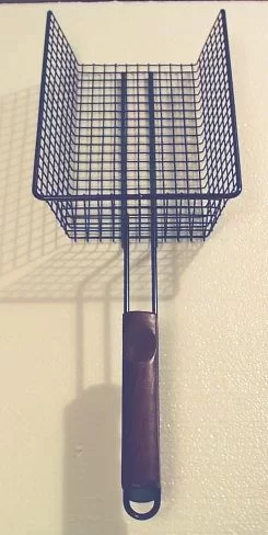

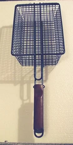

Although the little strainer shown in my earlier post works well, it's just too small. I finally found something that is MUCH closer to the ideal ash strainer. It is a modified Charmglow #662-039 Grill/Flip Basket, made for grilling seafood and veggies on the barbeque. I found it at Home Depot in the closeout aisle on end-of-season clearance for 7 bucks. It is steel with a 1/2" mesh and a nice wooden handle, with a 7"W x 10"L basket.
The mods are simple: Remove the basket flip lid, cut away the front of the basket (I used a dremel with a cutoff wheel,) grind the rough edges off, and voila. It works great, MUCH quicker than the previous one I used. I'll probably cut the length down to 7" at some point to make it a little easier to maneuver in the stove. But it's great as it is.
