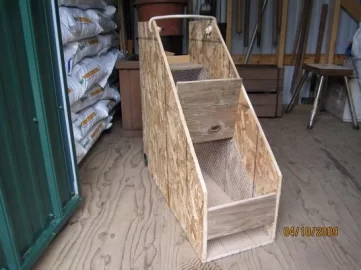

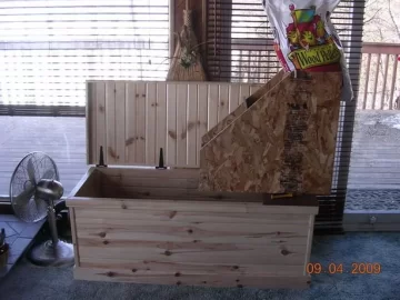

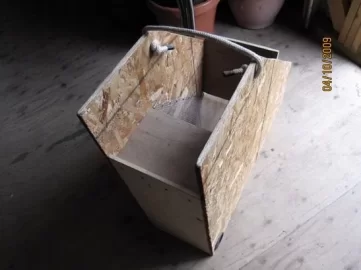

I'm with you in this one slls.....had it happen for the first time 2 days ago.... last summer I had been salvaging some pellets that got wet and tried to separate the expanding/crumbling pellets from the good ones..... I guess I didn't do a very good job as some of them went to sawdust in the hopper..... when my fire went out and I investigated, inside the bottom of the hopper where the cork screw auger was located was full of sawdust (about 10 cups full) and the auger was cavitating in it (not able to grab any solid pellets....... I sucked the sawdust mess out with the vac and immediately was back in business...... oh, and here's what I normally use to clean mine with.....when the pellets are dry..... :lol: ..... cc
click on pics to enlarge......

Nice setup, high production. I am low production, made some holes a little larger with wifes knitting needle.

how long does it take to sift a bag with that????

Granted, I am only about 7-8 tons into having a pellet stove, but based on what I have heard from neighbors whoh have had them for years (a few for decades) this "fines" issue seems to be more hype than reality. Don't the vacuum plans, sifters, and whatever that wooden contraption in the earlier post was seem to be a little overkill? If you put a whole bag in at one time and want to avoid most of the sawdust, just don't shake the bag at the end. I have found that the majority of the sawdust comes at the end of emptying a bag. Of course this is just one man's opinion.
