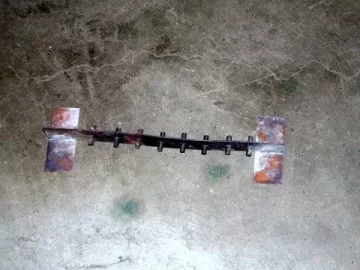

I have been burning peach pits for three years now, as well as pine, oak, apple, etc. Pleas see my gasification nozzle modification below:

How did it go? What problems and did you have to use log wood with them. Could you fill the uper chamber up?
Thanks. The mod spacer looks like somthing I was thinking of trying. How did it work>

The nozzle mod that radarblip made looks like a pretty good design. (Hope he answers soon)

Leaddog:
Sorry I'm replying so late... Basically what I do is in addition to my metal fab, I place two splits side by side on each side of the nozzle. I then put one grain scoop of peach pits on the left on the left side, one grain scoop of peach pits on the right side, and a 1/4 scoop in the middle. I fill the fuel chamber level to the door because these pits burn extremely HOT, and gasify excellently. My ceramic space glows cherry red: I get about 4 hours burn time per fill this way. My fabrication is 1"x1/16" stainless tigged together, with 3/8" stainless smooth steel rod inserted in evenly spaced holes and the tigged as well. I usually use these pits in the summer for domestic hot water, as well as at the end of the heating season (Marginal wood, if you know what I mean!!! ) ;-) I work for a fruit processor and I get about 14 tons (WET) delivered in August, a pile about 4 foot tall and 12 foot across. These are ready to burn at the end of October, leave very little ash, and I'm basically out of them by the following August. They are and excellent supplement to wood, and would recommend them to anyone

Thanks, I was hoping for that good news. I'm planning to get a bunch this summer. I new a guy that used them with a stoker for his sugur bush and said that he had to watch as it would tent to burn out the grates.
