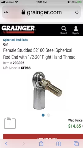

If you're considering welding I'd chop part of the arm off, add threaded rod, and put a heim joint on the end.
Does the heim joint go over the ball!

Drill straight through the ball socket at the end of the rod. Run a slightly thinner but longer bolt through the hole. Install one nut hand tight but back it off a turn or so such that this business can wobble around freely in the newly drilled hole. Then attach the long bolt to the other portion of the steering with a 2nd nut. Essentially making a "cheap" heim joint. That worked on my old LT 1000 for 3 or 4 years until I finally sold that POS tractor.
