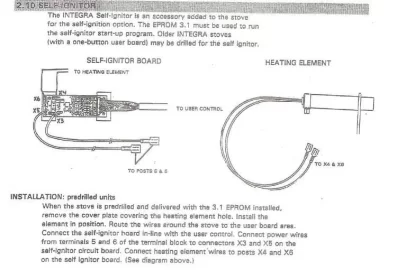

What is the cost of adding an Ignitor to an older AustroFlamm Intergra?

  • [Hearth.com] What is the cost of adding an Ignitor to an older AustroFlamm Intergra?
I had an older Integra until a few years ago. Really miss the reliability and the whisper-quiet operation. When I bought it I asked about the auto-igniter, and was told by the dealer at that time (15 years ago) that Austroflamm's ignitors tended to burn out fairly often. Of course they're probably lots more reliable now, but I always started the stove in less than one minute by this method:
