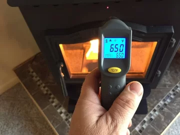

I have seen 650 when its really cranking.

That will melt tose cheap Wal Mart reading glasses................:):)

Maybe the viewing glass, but an IR thermometer can't read the glass 'cause it's a reflective surface..., I'd return it to HF too, it's off.
