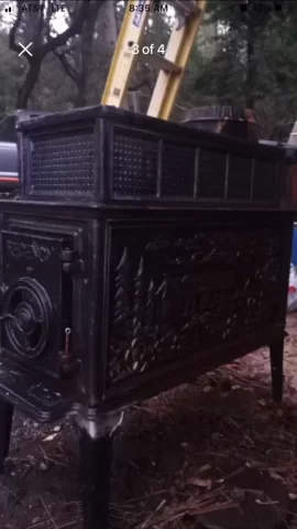

What model is this one?
amagana95667
Oct 30, 2022
2
Grizzly Flats, California

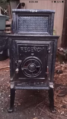

Can anyone help me find out the model? It’s one for sale and I may be interested but wanted to research it first.
[Hearth.com] What model is this one? [Hearth.com] What model is this one?
I’ve never seen a Regency like that. Jotul makes the F118 Black Bear that looks just like it and I know in the past there were cheap Taiwan knock offs of the Jotul.
Look around for other casting marks that might indicate the country of origin. Try the back bottom edge. It resembles this knockoff version on the sides.

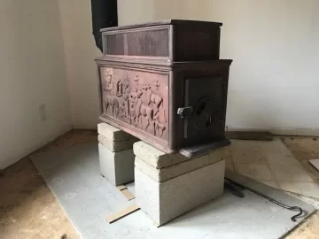

And i have 1 of those Jotul 118 clones.
But that Regency has a different casting design so not a "True" Jotul 118 original clone.
The Jotul black bear is a newer version of the original 118.

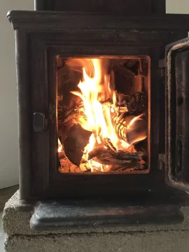

It does kick off some nice heat.
