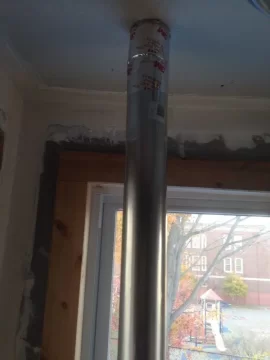

[Hearth.com] What not to do Link Removed [Hearth.com] What not to do Long time customer that wouldn't afford me the install called yesterday and wanted me to look at their new stove. Had a handyman install it for them but called me when it wouldn't work. She was very upset when I told her I couldn't work on it cause it was not installed right. Then....she wanted me to talk with her handyman to tell him what he did wrong so he could fix it. The nerve!

Is that regular duct piping?
I am not even sure what I am looking at....
Is that regular galvanized duct-work piping running horizontally out the wall with no class A where is passes through? :eek:
Edit: I see that it is running vertically not horizontally....and WTF is up with the duct tape? That doesnt look like high temp silicone to me....
Was the seal on the enclosed manual still intact?:) I don't know if one should laugh or cry.
OMG:eek: I don't blame you. I would run away too. Installed like that it's a lawsuit waiting to happen. I'd hate to be a tattle tale but I think I would show that install picture to your local codes enforcement officer or the fire dept. I may save someones life.

Picture needs rotating, me thinks, unless she has those special trees that grow horizontally. :)

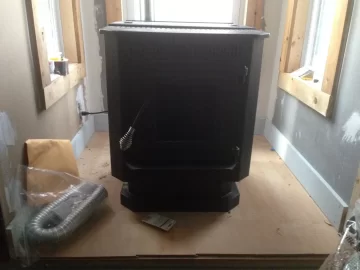

Some people just don't get it. She has a lot of nerve but not many brains! That even looks like a nightmare from servicing standpoint with it blocked in on 3 sides. No thank you.
Maybe trees installed by same handyman:)
The woodwork around the windows is really outstanding, too. I wonder what kind of chainsaw he uses............

Just noticed the laminate floor right to the stove... classy.

The really sad part is that the installation manuals are pretty in depth and have all the information you need to do a proper installation if you are even remotely handy and can read.

Well...... at least the fire dept will have easy access, being able to break all 3 windows around it, when they get called to "put the wet stuff on the hot stuff" ! :ZZZ Hey, but I guess that will just be another project for the 'handyman' to fix !

That pipe doesn't even look like pellet vent pipe. Almost looks like single wall dryer vent_g Look at the sku sticker on it, I've never seen pellet vent come with that on it.

1. no OAK
2. no thimble in ceiling
3. no surge protector
4. no floor protection
5. stove not specifically rated for alcove install so must be 8X8X8 alcove per NFPA211 (512 CF)
no idea what kind of pipe that is, cannot see labeling and scott didnt elaborate.
