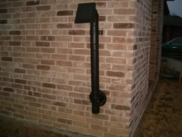

Post a picture of the outside portion of your vent system.

outside venting kit i got from Dura Vent

If I assume there is a 45 degree and a 18" piece of horizontal behind that stove and all of the vent is 3" would I be close?

I think I am gonna go higher with the venting like you are saying. I only got 4 ft and want to go up to 6 or 7' The backup power deal looks like a lot of extra money and confusing. Thanks for the help!
ya you pretty much nailed it. It has a small piece on the stove then a 45 then a 12" piece then the T outside to go up
