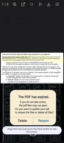

You will need to take your card out and verify to this chart. As for making the change, what you will see is a multiswitch
"block" on the card. You then just need to use a thin flat screwdriver to "rock" the switch to another position. According to
the document it is only one switch of the many on the "block"you need to possibly switch.

That Tripplite is simulated sine wave when on battery power
The APC may be pure sine wave (according to AI, it depends on the actual submodel). That is why I specified the APC BE850G2 - it is modified sine wave.
So, either you have a pre-2010 board, or the dip switches are not set for this to work.
