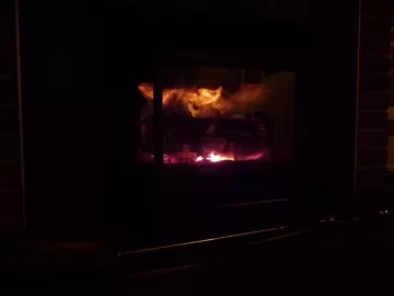

I followed "Abhoth" method in this thread https://www.hearth.com/talk/threads/32665/ and it sure takes off like hell.
I get it burning real good then I dampen it down to almsot closed. It seems if I close it all the way it starts to shut down. Do I want to see flames or just nice glowing red hot wood? I get it so the is some fire dancing around up near the inlet air tubes, I assume that is good.
10 Degrees F here and I got the place cooking at 73 in the room and keeping house warm.
Thanks
here is a pic
infared temp guage is reading 482 just above door on main unit plating

Sounds good to me...however, you should always have flames in the firebox until the wood is reduced to coals.
Otherwise you will just be smoking up the neighborhood. (CAT stove excluded)
:coolsmile: Nice burn, stay warm 450 to 550 isa good surface temp.

Well I'd say when you get down to coals you should have already gotten to the point of having the air shut down. Once you damper the air all the way down you should have a pretty good roil going still, but it'll be the slow-mo ghost flame burn. But result's are very dependent upon the type of wood and the seasoning of said wood... That initial burn with the air fully open for 5 or 10 (depending) is to get a good char on the wood and burn off any water ... all wood has a little. Using that method you should be able to close the air supply all the way down after about 15 or 20. But that does depend upon the wood, if it's pretty damp or wet and you shut down the air it might try and go out or smolder. Don't want smolder! ;-) So, if it tries to go out then open it up a bit, maybe an inch, and let it go for 5 and then try to close it down again. But if that picture you posted is with the air closed down then you're fine... speaking of... I'd better go stoke mine up a bit!
