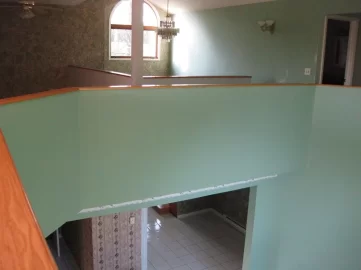

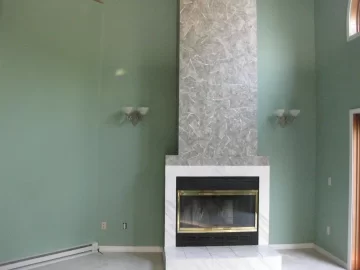

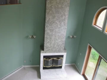

I am buying a new house and it is an all electric base board house. So i am instantly thinking $$$$ in heating cost for the winter. So my question in your opinion would heating my whole house with a pellet burner work? The house is fairly new (1997) It seems to be well insulated. The house is about 2900sqft. My question there is a insert already in place in the living room. I was thinking i would replace that with a pellet stove and i should be good. The layout of the house is a colonial style with cathedral ceilings about 30ft tall. There is a ceiling fan and the upstairs is open so you can look down onto the living room from the second floor. Do you think a pellet stove will heat the whole house? Also what type of stove do you recommend? I have included a pictures to show you what i am working with.

I'm thinking you would have a really warm upstairs, but keeping the heat on the main floor would be a pain because of the cathedral ceiling. If you decide on a pellet stove, I would think of it as supplemental heat (or at least go in thinking I would have to use electric heat too - just not nearly so much).

mid 60's should be doable with a big insert if it fits the opening,you would be much better off with something like a harman p68 freestanding on the existing hearth.
That was my plan was a bigger free standing pellet stove. I was looking at the Harman P61 or P68. I was going to take the insert out and put in a free standing and just connect it to the existing vent. The only question i really have with that is that it is just a stick built fireplace with drywall built up to look like a chimney. I do understand the venting has to be so far away from the wall depending on the type of venting. So will it be fine to leave the stick chimney if i ran a Harman?

As for your chimney.... What is in there now? If it is a zero clearance you may not be able to use existing flue etc; I would consider a direct vent straight out the back thru the fire box or close by. This I say for several reasons. One, there is less venting pipe and fittings to buy which keeps costs down considerably. It is simple to do and install. And much easier to clean and brush out ash as needed. Keep it simple and install an OAK. People arguing against installing an OAK Outside Air Kit are also lost and really can not grasp how air movement and heating and cooling really work either. I don't care who i tick off with that statement. Kinda like uneducated hill billies arguing about the colors of trucks. The red one is more powerful,,,,, "well because it is red and that's why."............ They miss the whole shebang because it is a very black and white color issue. Drive that red truck until it is on fire and keep filling up that big tank on that 8 MPG puppy is all I can say.

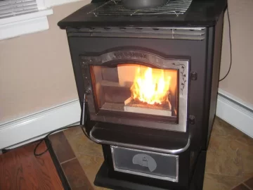

Do you have a picture of what this looks like?
Pictured is a P61A ..
1000 SQ Down and 1000SQ Up.
straight across the room is steps to the upstairs...
at top of steps is a ceiling fan set to turn clockwise at the lowest speed.
once the air flow get's going, the upstairs stays a steady 68 degrees all winter give or take for Super windy nights providing the stove is running 24/7
downstairs stays approx 74 degrees with my stove distributer fan Only on Half speed. [Don't want to try and see if the walls downstairs will melt]
If a Harman P68 is overkill for me [which it is], should be perfect for the Original Poster..
It's my avatar picture. I blocked off the hearth opening with a removable metal panel, built a self supporting stove base on the hearth, secured it and set the stove as shown. Did the whole install in a couple of hours after I pre built the base.

At least the OP's house is pretty open concept, that's favorable. My concern is the cubic feet needed to heat not sq ft. Obviously it's going to be key to push air down with that high a ceiling arrangement. I imagine trying fans in both normal and counter rotation will be tried. I've found ( we have three ceiling fans here) that at the top of the stair well we need to push down, course it's a pretty closed stairway and the fan is over a landing with a 90 deg turn then up 3 more steps to an upstairs hallway. But in outer rooms on the main floor we run in reverse which pushes air up to the ceiling and down the outside walls in both cases. That works better than no fans or standard rotation by some degree but not like that upper stairwell fan does. I'm guessing if we reversed that stairwell fan we would bake in our bed at night. But having that fan push down helps distribute downstairs air out those outer rooms.
I think in the open concept with really high cathedral ceiling I would run the fans in reverse to start and try and push the trapped air up there out to the walls and down. I would start there but it's going to be quite a task IMO. it would help with multi fans I imagine. I worked in a shop with 25 ft ceilings and have two fans per side of the building really made a huge difference in the comfort of the place and cycle times of the heaters in there, I mean really significant. To try and heat that shop on single digit days the heat ran literally all day long trying to make 67 deg. With the fans running it cycled on and off all day long up to the setting of 68 where we kept it at normally. That was with two 90,000btu gas heaters. It was a shop not a house, open doors , heat it all over again LOL. But the fans were hugely effective in that case.
