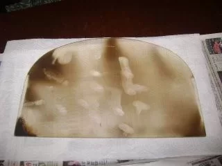

In addition: Did something change in your burns? Do you get a lot of soot on the glass especially always in the same spot? Is the secondary burn any different when you close the air completely? You can do the dollar-bill test. If you tug on it and it comes out with only slight to no resistance a new gasket may be warranted.

Thanks everyone! It failed the dollar bill test, and I also have soot continually on the left side desite hot burns. Does anyone know of a good source to buy gaskets. I refuse to buy anything from the guy I bought the stove off of.
