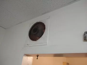

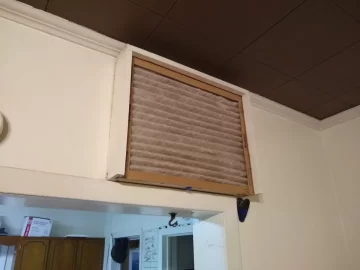

On top of the stove is a good idea. For us the stove is in the living room pointed toward the kitchen. However the kitchen and that part of the house never seemed to get warm so this is what worked for us. Cutting a hole in the wall near the ceiling and adding a filter for it. During Harvest season we are changing it weekly. The kitchen is much much warmer after we did that. Was a good way to move the warmer air.
