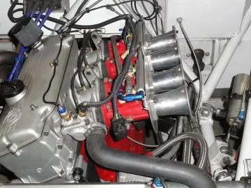

[Hearth.com] Which bearings ? It's an M10 2 valve 2 liter engine the rods are Carrillo knock offs with ARP L19 bolts. It will actually revs higher but its our of its power band.
