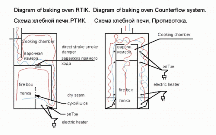

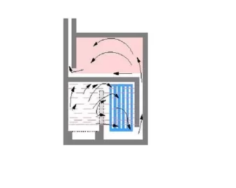

Hello Ugly,
It looks like Igor Kuznetsov, the Russian stove designer, has spent his whole career dealing with that question -- the ablative effect of excess gasses ("ballast gas") he calls it -- not directly involved in the combustion process, but being dragged through any forced draft system soaking up heat and costing efficiency. If you are into stove/furnace/boiler design, yhou'll find lots of interesting ideas to chew on at his website
http://stove.ru/index.php?lng=1
Lately he has put up a power point presentation that explains his 'free gas movement' designs (as opposed to 'forced gas movement'). There isn't much new under the sun in the wood-burning world. But I've never seen or heard of anything like this -- something for sure to cogitate on and investigate. Below are 3 sketches from his website which hopefully convey some idea of what he is talking about.
