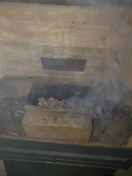

Hello... so I am going to post yet another it doesn't burn post (sorry). My question is going to actually be about cleaning this thing because I'm sure I'm missing something subtle...but hey I don't mind being wrong either :)
So specifically I just picked up a Whitfield advantage plus stove used a little bit ago and I am getting around to cleaning it and install it/etc. This model is a manual light model...so I'll do that with firegel and let it catch for a few seconds and close the door and attempt to start. The problem is at that point it just smolders out after a short period of time.
Things tried so far
  • Pulled every nut/bolt/cover/etc off and vacuumed all dirt that can be reached. This includes all motors (combustion/room/auger/etc) and internal plates/the fire brick stuff/etc
  • New door gaskets and window gaskets/gaskets for combustion motor/etc
  • Tried another known good combustion motor just in case the current one was staring to die. same results
  • Once all seals were set... leaf blower cleaning just because. (yeah my garage still has a layer of flyash from that one lol
  • Played with the damper on all sorts of settings (between open / close/etc)
With all of that...the fire still dies out. By all accounts this should work and it doesn't. I suspect there is fly ash caught up in the burn pot vents on the top left and right but for the life of me can not see a way to get in there for cleaning. I could be wrong but this thing has me befuddled-ed
Any thoughts or insights would be greatly appreciated.

Mine smolders out if I don't put enough accelerant on the handful of pellets I put in the burn pot prior to lighting it. I use barbeque lighting fluid as an accelerant to get the pellets burning. Maybe you should be more generous with the fire gel.
It's that or the temperature sensor is faulty and it isn't telling the control board that the stove is hot and the auger is shutting down after the programed warm up delay period.
Hello,
I tried using more fire gel and the initial fire was better but after this it smothered out after about 15 minutes (ish). As for the high temp sensor...I was initially hopeful of this but during the burn test tonight it continued to feed pellets the entire time :/ I've worked on a number of these...but honestly I'm kinda stumped. Going to figure it out...it is now a moral imperative :)

Looks like it's starving for air. Google leaf blower trick.
Does the flame from the fire gel get more robust after you close the door? If it doesn't, then combustion air isn't getting to the burnpot.

it definitely seems like it is starving for air once the door is closed after a while.. I've already done the leaf blower technique twice and have had all of the motors off and cleaned every darn corner of the thing I can get to inside and out. This problem just feels to be a airflow issue but can't quite seem to find where the blockage might be.
