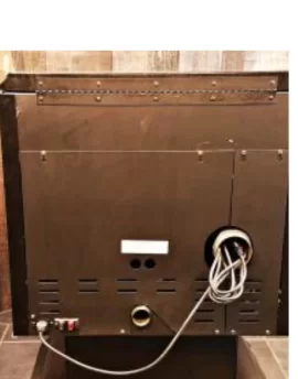

Pic 1 - Original back with little ventilation

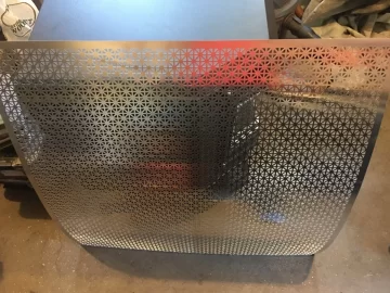

Pic 2 - Metal sheet

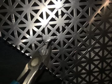

Pic 3 - cutting around protruding parts

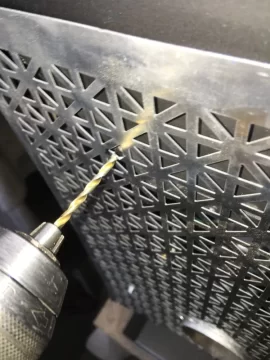

Pic 4 - Drilling Mounting holes where needed

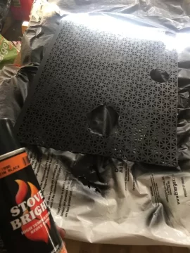

Pic 5 - Painting with Stove Bright 2 Light coats

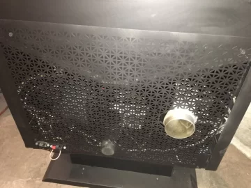

Pic 5 - All Done!
Pic 2 - Metal sheet
Pic 5 - All Done!
