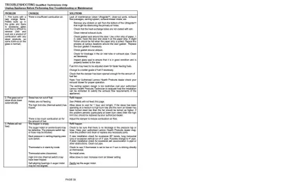

What does your manual suggest in the troubleshooting section? Couldn't find manual for your stove but the whitfield advantage IIT troubleshooting mentioned this; know your's is a different stove but...
Check the wire connections on the high limit disc and control board.

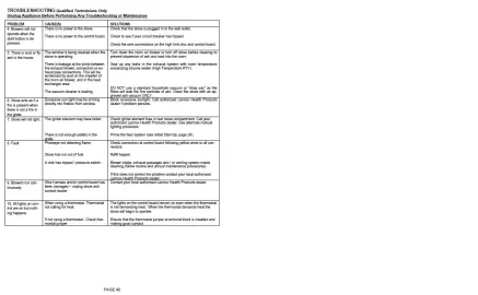

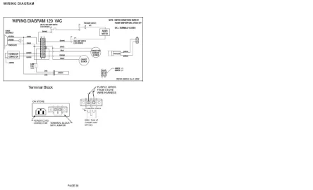

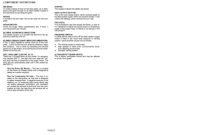

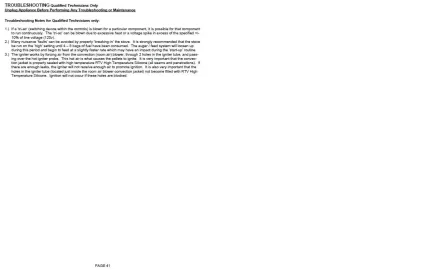

If this link doesn't work, I've also attached the relevant troubleshooting pages to this post ( including wiring diagram ).
Problem #4 on page 40 is relevant to your situation, and the remedy has already been suggested by other members in this thread.
Problem #10 on page 40 could have further interest... it describes what could happen, if the thermostat jumper on the rear of stove has jumped off, or has a bad connection, so please double check the jumper.
