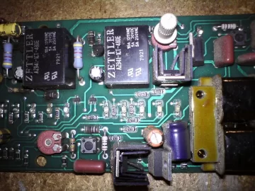

You could open the control board and take a look at what is written on the relays on the pcb. A couple of years ago I did that on my stove and took some pictures of it.
Your Advantage Plus and my Quest Plus have different control boards, but since they both belong to the same generation ( late 90s ), the relays on your pcb might also be manufatured by Zettler.
We see two Zettler AZ941-1CT-48DE relays on my pcb... one is the bypass relay and the other is for the igniter. Datasheet here for details: http://pdf1.alldatasheet.com/datasheet-pdf/view/283899/AZETTLER/AZ941.html
