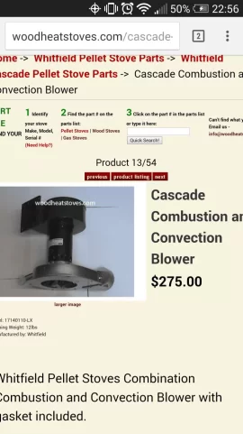

This could be the issue. I'm not sure how fast they are suppose to spin but it seemed to be moving a descent amount of air when I ran it before I put it back together. One other thing I noticed what that this unit has two separate blower motors. One for the combustion/exhaust and one for the heat exchanger. Everywhere I look on the internet says this model is suppose to have one motor that runs both fans?
As far as I know, and that is very limited on the cascade model, it is supposed to have the combination blower. This one:

I have a cascade that im not burning , and it has the double shafted motor . I've never seen a cascade that didn't. There's allot of spots for ash to hide in that stove . When I got my stove it was packed with ash and burned terrible .
