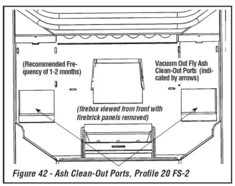

It took you 4 hours to figure out and we're supposed to without even seeing the stove?
But I'm giving you guys a big heads up.....it's missing something and I'll give you another hint, it's in the firebox...think air flow
A loose set screw on the impeller could have caused the impeller to fall off the shaft of the combustion motor... that would result in this issue. Don't tell me that the impeller was missing!!
not the impeller.
The lids for the ash clean out ports behind the fire brick?

The ash slide plate?

Yes......! You got it!

Ultra plate is different. Though the ash slide plate doesn't completely seal the opening . It does restrict some and divert the rest of the air flow so the hot air hits the pellets. Pm your mailing address and t shirt size. Good job.

I put this up as a contest to raise some awareness about issue that is actually very common. Whitfield was smart to incorporate this slide plate as a way of negating the issue. Travis (Lopi and Avalon) also use this type of plate. This was the very first time that I can remember a stove not lighting because if it, cause c'mon, who removes the plate? Right? Ultimately, I guess there could be a safety on the plate that keep the plate from being removed. There is a safety there to make sure it's closed. The door wont shut unless the plate is seated properly.
In the stove, there needs to be a roughly 35/1 air to fuel ratio. When the stove is running, it is pulling air from the intake into the burn pot, but air is also coming down the feed chute from the hopper. If the ash pan were not seated and sealed...and the Profile series does not have a sealed ash bin, air could also be taken from the left and right sides of the burn pot up the ash dump holes...this would be bad cause a potion of the 35% air would miss the combustion zone. VERY COMMON IN ALL ENVIRO STOVES with the exception of the Maxx, Mini-A and M55's.
