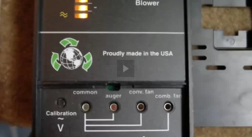

Ok, next step is to measure if the control board sends out the correct auger voltage. On your control board you'll find a test port for the auger voltage under a plastic lid ( see picture below ). Caution: The voltages on the test ports carry mains voltage, so take care!

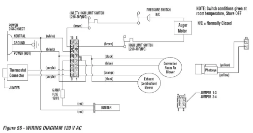

If auger voltage from control board is ok, then you have two high limit switches in series with auger that could be faulty/open. See diagram.
